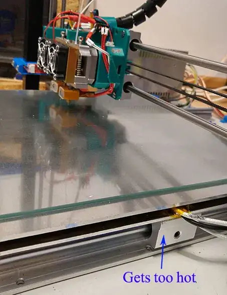

I have successfully assembled my custom-built 3D printer and configured Marlin for two extruders and one heated bed. Here is a picture of the printer.
My heated bed runs on a linear axis with ball bearings. When the printer has been running for an hour or so these parts get really hot and I am afraid that the plastic parts will melt if I print any longer or with higher temperatures. So I decided to add fans below the heated bed to keep them cool.
