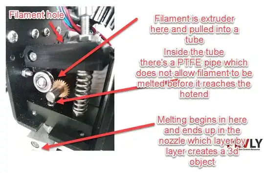

From the comments/answers to your main question, the likely culprit is the hobbed wheel not catching the filament firmly enough.
The hobbed wheel I am referring to is the yellowish one at the centre of the picture. The problem could be due to:
  • the wheel being of poor quality, with blunt teeth
  • the wheel being of the wrong diameter (too small)
  • the spring squeezing the wheel against the filament being too weak
  • [judging from the picture, I don't own the A8] it could even be that the nut on the lever that is pushed by the spring (top right of the picture) is too far down on the threaded rod, and prevents the lever to move far enough to push effectively.
mac
  • 4,557
  • 35
  • @MF did you add the fan on the extruder ? I had a hard time setting the spring correctly in place with the new screws when assembling mine. This could be the reason why the 'steel guide wheel' isn't pressing enough the filament against the hobbed wheel. – Tensibai Jan 03 '18 at 09:59
