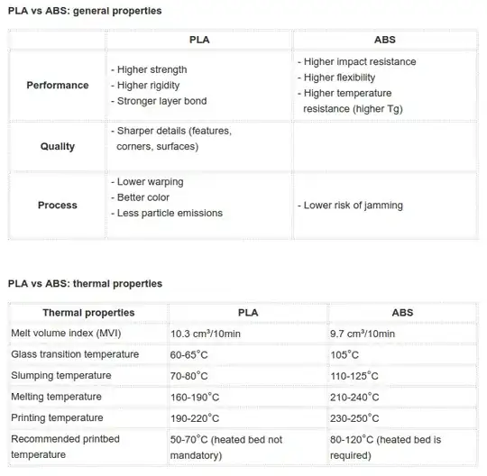

PLA/ABS general and thermal properties
PLA vs ABS general properties PLA ABS Performance Higher strength Higher rigidity Stronger layer bond Higher impact resistance Higher flexibility Higher temperature resistance higher Tg Quality Sharper details features corners surfaces Process Lower warping Better color Les particle emissions Lower risk of jamming
Ales Rebec
    Please do not use images as the main content of your post, *especially* if it's an image of text. It's not search engine or screen reader friendly. While images are great for including diagrams and illustrations, if you have textual information *please use actual text*. Also, are these images your own work? If not, it might not be legal to include them here in the first place. At StackExchange we expect people to write their own answers, not just copy something from other sites. – Tom van der Zanden Jul 21 '17 at 03:25
    Why image? StackExchange only allows basic HTML tags and table is not one of them. ` https://meta.stackexchange.com/questions/1777/what-html-tags-are-allowed-on-stack-exchange-sites We do not (and will not) allow tags. Sorry. This is intentional and by design. If you need a quick and dirty "table", use
     and ASCII layout.
    Not searchable?
    https://support.google.com/webmasters/answer/114016?hl=en
    Added!
    Legal issues?
    Created my own table from what I learned.
    – Ales Rebec Aug 02 '17 at 09:50
