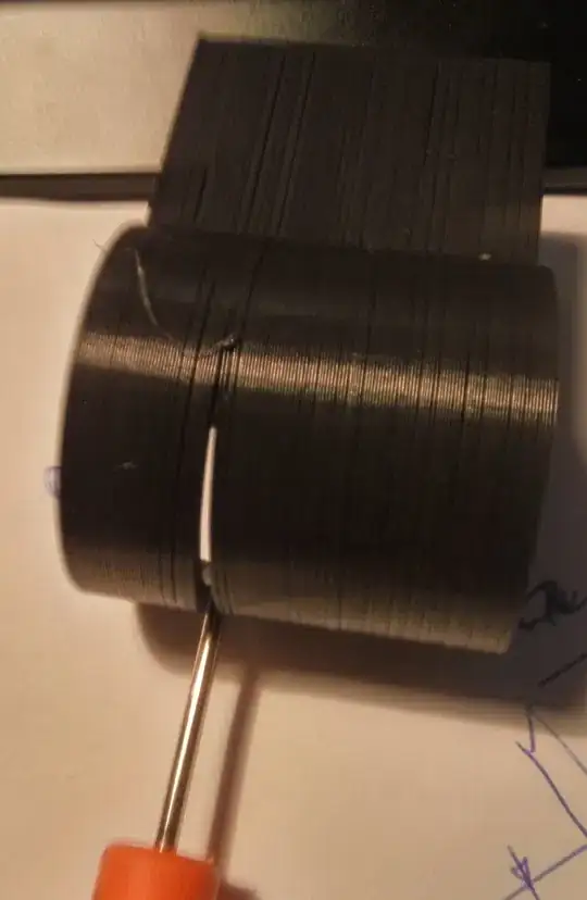

Here is an image from when I stopped mid print (you can see the little ooze string just at the start at the crack) for checking dimensions. The next layer didn't bond well because, I guess, the already printed part had cooled down when I un-paused the print (say 1 minute later) or maybe the z-axis went off a bit when I touched the build plate.
Sorry for the bad quality, I forced a screwdriver in the crack for visibility

  • @Valmond Oh sorry I completely missed the question. I took it as "What can I do to increase layer bonding". To answer your question, You can't unless you measure the amount of force needed to destroy the print or by visually inspecting it. By the picture you provided I see many small gaps every 5-15 layers and I can assess that those are your weak points. Your best bet is to fine tune your printer and/or settings and test the parts destruction. If your confident in their strength, using PETG and other stronger filaments should give you a clear head on how strong your prints will come out. – Athanasios Karagiannis Nov 17 '17 at 19:12
