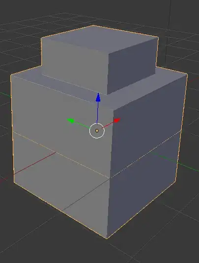

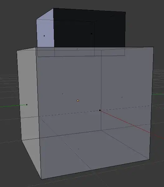

Let's look at it...
It's something like this: a closed box with protrusions that have no inner surface. like this cobbled together thing.
Box with pseudobox

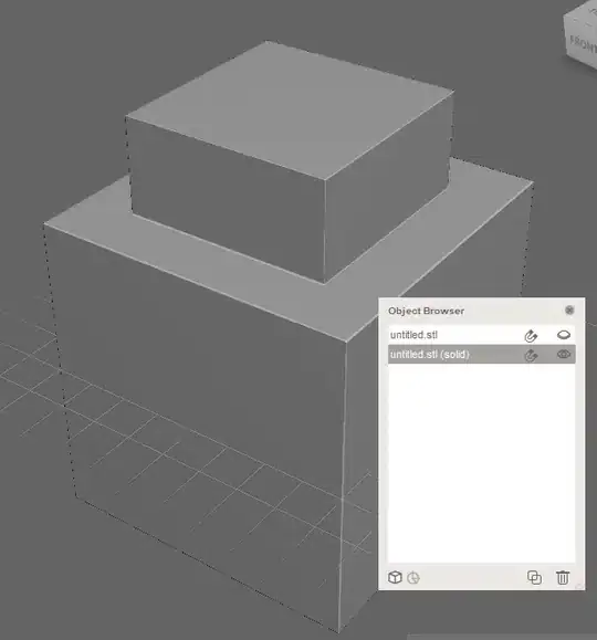

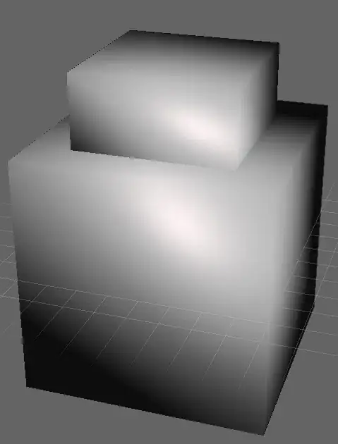

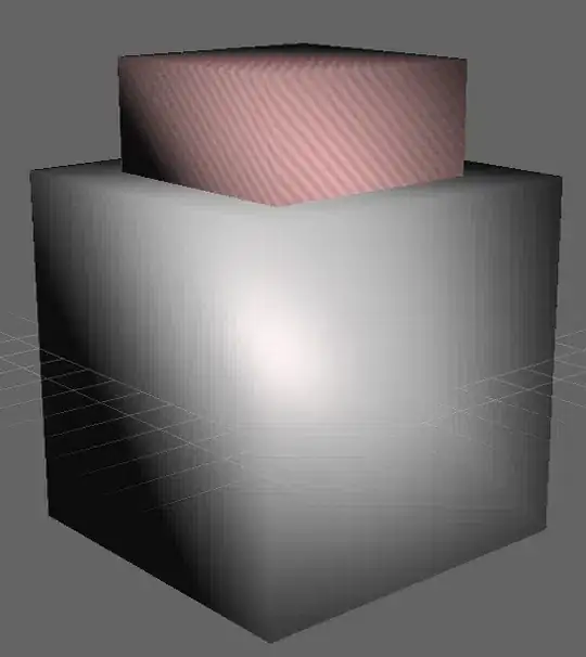

Let's just for fun export it as a .stl. yes, a single .stl file. And now open it in MeshMixer:
MeshMixer view of the same model
Looks not half bad, right? But a red box? What shall that mean? look at the blender model again: Oh right, the normals on those surfaces are backwards! W F in blender flips the normals, reexport the .stl, reload into MeshMixer!
After flipping the normals in the top "cube"
Now we are talking! Let's look how we can fix this... Edit > Make Solid with a high Solid Accuracy with both a high Solid Accuracy and Mesh Density results in reasonable sharp corners and... DANG! One solid body, all neatly closed.
After solidifying Now, test: Export (ctrl+E) and import into blender.
Solidified in blender

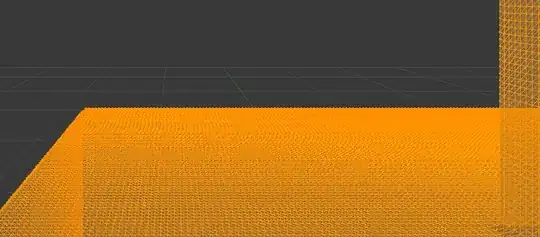

Yet, we got a problem: this thing that had been 11 faces and 16 vertices became almost 1.2 million vertices and 2.4 million faces. This surely can be condensed some, but we just achieved a well printable merge of the objects.
New mesh of the corner geometry
