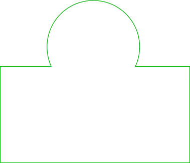

here is just a addenum to Tom van der Zanden's answer

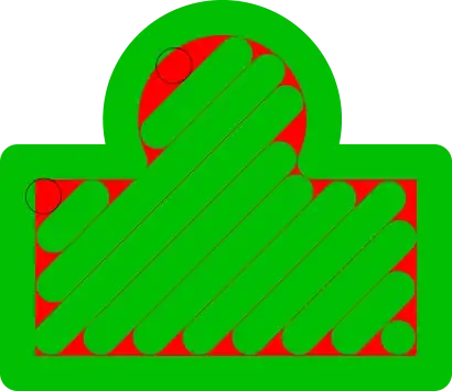

this is (an example of) what you may design - nice object with virtual outline, and virtual fill so this is what you see (and what you potentially expect)
but here is what you get (and probably not really expect)
red parts are the areas which are not covered by fill because nozzle cannot reach there
solution is
  • to redesign your object in smart way or
  • to use smaller nozzle or
  • to use smarter app (like Slic3r)
and of course you can use all 3 options together to get best results ;)

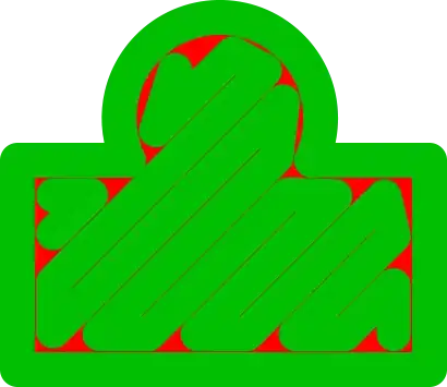

EDIT here is simple explanation why smarter app could do the thing enter image description here
and here goes the difference
green parts are new covered areas
not much but somthing extra

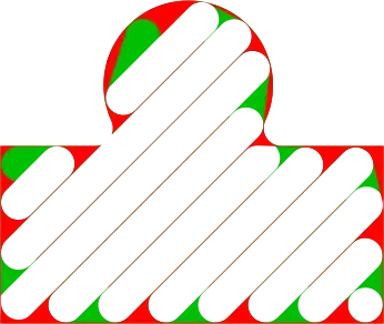

This is likely not a problem with your mesh. It's a problem in the slicer software.
Because your 3D printer prints with a (for example) 0.4mm nozzle, it lays down lines of plastic that are around (for example) 0.5mm wide. The slicer has to create a pattern, consisting of 0.5mm wide lines, that fills in your object. The gaps shown in your object are likely smaller than this, and thus can't be filled.
I am not familiar with the flashforge software, but different slicers have different ways of dealing with this. Some offer a "gap fill" option that uses tricks to be able to fill in these very tiny gaps by rapidly moving the extruder back and forth over the gap. However, even then, it is sometimes unavoidable that tiny gaps remain. Some gaps are just too small to fill with the comparatively large nozzle.
