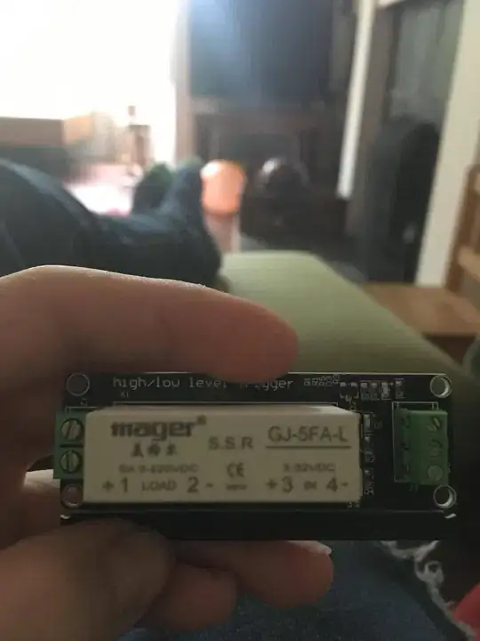

I ordered a MOSFET module on eBay for my 3D printer and I did not get the one in the picture but I got this:
The thing I received
If there is any way I could use this on my Anet A8 could someone tell me how, as it only has one input connector, DC in, and 12 V out.

No, this module is completely useless for your intended purpose.
The load side is marked with "5A 5-220VDC". This means it can only switch up to 5A, maximum. The heated bed draws more than twice this current.
