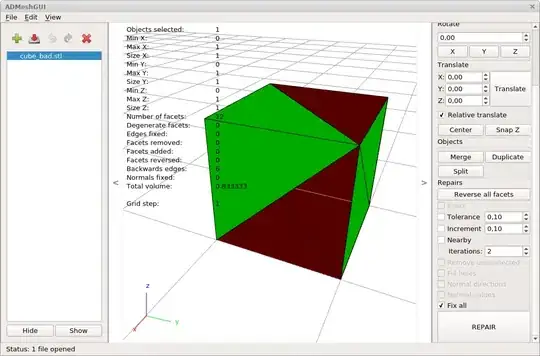

Using ADMeshGUI:
Find ADMeshGUI at github.com/admesh/ADMeshGUI.
Open the file and click the REPAIR button in bottom right. See the changes.
ADMeshGUI
