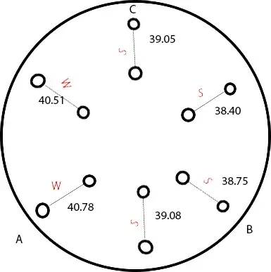

I have make a little test with 4 dots aligned with A tower, B and C tower. Distance W and S are the same in the stl but not in the print. I have tried diferent values of diagonal root but S always is smaller than W, and all S are equal (more or less 38.20mm) and all W are equal (more or less 40.80). I expect that W and S will be 40mm. How can fix this problem?
Update:
Here is the stl I use: https://www.dropbox.com/s/2vwjbo387cmk5qa/DeltaCalibration%20v15.stl?dl=0
Update: I have replaced the steper motor in tower B but same result.

I bet your towers are not standing straight (vertical) or your bed is not clearly horizontal

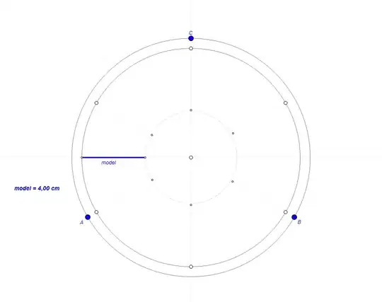

I've recreated your picture with some assumptions (for example that your SW calculates properly and your steppers and motors act well).
Take a look here: enter image description here
If you deliver your printer dimensions
  • tower height (from the base)
  • tower distance from the center
  • bed distance (height) from the base
I can calculate what the inclination angle on all towers is, but, I suppose it's not really important.
The important thing is to set them straight/vertical (perpendicular to the bed).
We can see from the picture that tower A is the most inclined to the center or the bed highest point is next to tower A (and I bet one of those or both cause the issue).

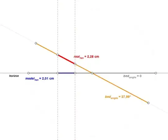

As for the explanation why bed the inclination causes dimension distortion:
This is exaggerated but it's just to show the issue.

  • Thanks @darth_pixel!, the problem was the bed inclination. After fix it, I had to modify the end stop position, and the horizontal root length. I'm still having an issue with the C tower now, but I think It could be a problem with the printer frame. Could be great if you can explain why bed inclination and end stops affects to the accuracy. – TlmaK0 Sep 26 '17 at 11:32
  • @TlmaK0 take a look on edited post. to be honest i don't really know how endstops could have any influence on accuracy. no idea at all... well i would say it cannot have such influence ;) – darth pixel Sep 26 '17 at 12:22
