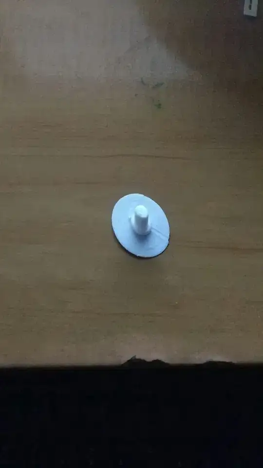

I am having issue with my new printer it is not printing circles correctly although I have change firmware and stepping of motor
advise if anyone know the solution.

X axis pulley is 20 teeth with the calculation it's 80 step y axis is 16 teeth pulley so it's 100 step – Dream Developer Sep 13 '17 at 15:59

Possible causes for the printer not printing correct dimensions:
- Incorrect number of steps/mm in firmware settings
- Belts are not tight enough
- Pulley slips on the shaft
Looking at the picture, I would go for the first case, because distortion looks regular. Try checking microstep settings on your board, and settings in the firmware.

1yes did it with first case although against the calculation which I did. changing microstepping work out – Dream Developer Sep 14 '17 at 16:00
This could be because your belts are either old or not tight enough. Try adjust or replacing the belts and try again.
