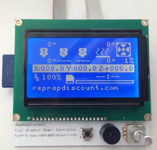

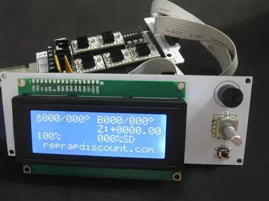

RepRap based printers use LCD modules with control button and SD card. You can trigger operations like
  • nozzle heating (to change filament)
  • extrude filament
  • home axis to caliber bed level
Most used LCD modules are:
RepRap firmwares (Marlin, Repetier) are supporting it. To get better view on what is supported, take a look on Marlin language file.
amra

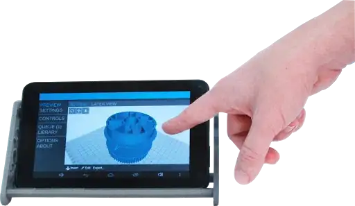

There are options for tablets. They are running software (for example) on some device that has internal storage, wifi, USB connection etc. You can buy a new tablet, or reuse your old one just to be a controller.
Another great example is this app.
Apps have menus that can arrange everything for you, now it depends on what app do you use and what filament you use. It's very simple thing.
