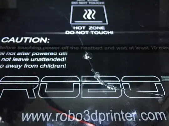

I have a Robo 3D. However A while ago, the print bed was fractured, and now it has a long crack cutting it in half. The bed still works because it is held together, by the screws holding the bed to the tracks. So I want to continue using it, because it still is fairly good, the heating element works fine, and a replacement bed is 80$, and I am unsure if the one sold on the RoBo 3D website will be compatible with my printer as I don't have the R1, but a version before that.
My cracked bed, with crack running straight through the center
So my question is: How can I best align the two glass fragments, to provide as flat a print surface as possible, and two how to best hold these two pieces in place, or if it would be best to invest in a new print bed?

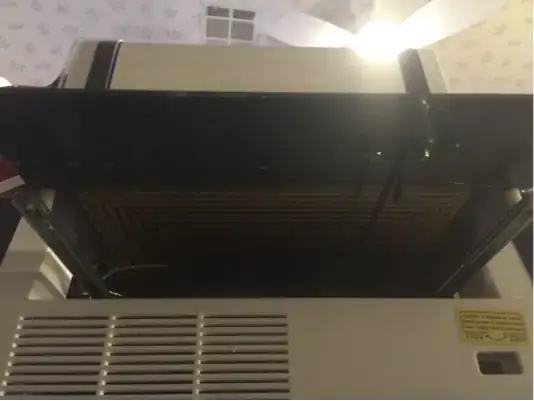

EDIT: Here is a image of the heating element as well to explain the situation with how it is attachedThe heating element attached to the underside of the glass print bed

A little chip is fine, but I wouldn't print with that big of a crack. However, that doesn't mean you need to spend $80 on a new sheet of glass.
Option #1- If you want borosilicate glass, you can get a sheet from either McMaster (about $40+shipping for a 10"x10" piece, less for smaller) or from a local glass maker (the price varies a lot, so you should check that also if you want to go that route). However, you won't be able to drill holes (tempered glass will break of you drill a hole). Borosilicate glass has the advantage of being extremely heat-resistant, so it won't break from thermal expansion. If you go this route, you should pick up a few binder clips also to attach the sheet to the heated bed.
Option #2- You might be able to get picture frame glass from a hardware store. It's super cheap (mine was $3 or something from lowes) and they'll often cut it to exact size. You might be able to drill this, but you have to be extremely careful. Sometimes, the hardware store can drill holes in the sheet for you if needed. If you don't want to drill, a few binder clips will work just as well.
Just a note for if you are using binder clips: you might need to (depending on how your hbp is set up) get a piece of glass that is slightly smaller to allow for any bed leveling screws to have room. If you're going with the picture frame glass, you should make sure that the glass will be entirely within the heated part so that there isn't any heat gradient (that's how glass cracks/shatters).

Replacing your bed is the safest option, especially if you have a heated bed. Cracks and chips in the glass create an uneven surface for your prints, and can become a safety hazard; additionally, while borosilicate glass is very resistant to thermal shock, it can continue to crack or shatter when subjected to rapid/uneven temperature variations after damage. Borosilicate glass tends to break in large pieces rather than shattering (snap instead of splintering), but it's still a safety hazard.
It sounds like you have the Kickstarter version of the Robo3D R1; the current glass bed on the Robo3D uses magnets to hold the bed in place, so you'd probably need to replace your Y axis rails along with the bed. I would contact Robo3D support to see what options you have available for upgrading the bed and rails through them.
Aside from Robo3D, you have a few options: - If you plan to continue using the bed, Kapton tape is an effective surface application for general printing. It's very thin, but provides an effective surface for ABS & PLA adherence, works with heated beds, and is compatible with secondary adherence items (blue masking tape, PVA glue, ABS slurry, etc). Kapton tape can be damaged after several prints, so plan on having several sheets on hand. - You can replace your current borosilicate glass with a new sheet of borosilicate glass from a secondary source - Aluminum plates are an effective replacement - Lexan sheets also make an effective replacement, but I wouldn't recommend applying heat to them.

If your heatbed itself is aluminum/copper/other metal: Get a glass cut and replace it. The current one is probably attached to the heatbed with adhesive glue. If it the adhesive is cyanocrylate based, you can remove by rubbing with acetone. If silicone type, it will come off by some force. Don't worry, you won't damage aluminum. THe heating element is either inside the aluminum or under it. If it's not alumunum it's likely a PCB heatbed. Then I wouldn't suggest to use acetone or some "antiglue" and would just try to apply a little force and see if the glass moves a bit. If no, don't bother, PCB heatbeds can break too. Then I'd just suggest to apply some epoxy to cover the holes surrounding the cracks and keeping the glasses uniform.
Also, about replacement glasses: picture frame glasses are very cheap. McMaster sells some high quality bearings and rods, but for glass there's no point to waste money. $5 is typical for that size borosilicate glass, if you're in USA (I'm not) I think your local Home Depot will cut it for free for you as well.

I agree with several others that your best bet is to replace the glass entirely. But short of that, you might try something like Loctite "Glass glue", which is essentially crazy glue for glass. Be sure to level and clamp well while drying, or you'll end up with it permanently not straight of course. You'd want it clamped to a very flat surface, and clamped pushing the broken edges together. But I think I'd just replace it.
