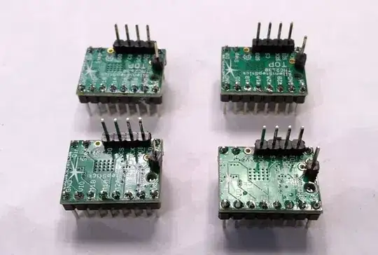

Trinamic drivers
Most of the noise is created in motors.
Definitely switch to Trinamic stepper motor drivers. I have upgraded from Prusa i3 mk2 to mk3 last weekend and the noise reduction is significant, my estimate is 80-90%.
Take a look on this awesome blog post and video from Thomas Salanderer about the driver. Other good post is on instructables.
I would not suggest soldering unless you are a skilled hacker. Better option is switch to different board.
Prusa i3 mk3 is using Einsy Rambo 1.1 for $120: https://ultimachine.com/products/einsy-rambo-1-1 But there you have to switch to 24V Power Supply Unit and you have to also switch to 24V heated bed.
Another solution is to use RAMPS and buy trinamic drivers separate (RAMPS doesn't solder drivers on the board).
Additional info about trinamic drivers: https://shop.prusa3d.com/forum/hardware-firmware-and-software-help-f64/tmc2130-driver-infos-and-modifications-t15835.html

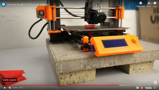

Use a concrete paver as described in this youtube CNC Kitchen channel. It reduces noise by 20dB (not if you use trinamic drivers).

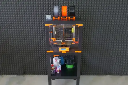

Enclosure
An enclosure should also help to reduce noise.
How to build enclosure from Ikea table: https://www.prusaprinters.org/cheap-simple-3d-printer-enclosure/

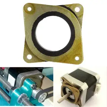

Dampers help you reduce noise. There are two types of dampers:

    The dampers are useless in combination with Trinamic and they also reduce the cooling of the steppers. Also, if the issue is noise from different floors, the stepper drivers won't help because the high frequency vibrations are not transmitted much between rooms. Lower frequency vibrations are. – FarO Jul 27 '20 at 19:34
  • Great answer. Two things. First, stepper dampers as depicted could also decrease the print quality. You want a stiff connection between stepper and drive. On the other side, if belts are used to transmit the movement, it also has a little flexure. Second, the depicted base damper, is this a damper or a spring? What dissipates the energy? – 0scar Oct 20 '20 at 11:10

I use a paving block with rubber feet underneath it on the floor. It is very effective: The 3D printer is sitting right beside a door, and you can't hear it printing from the other side of the door.
The low-frequency sounds are definitely absorbed by the paving block. What you can hear now are only the hissing sounds, when the extruder glides along the rods.
I wouldn't put the paving block on a table, though, or anything elevated, since that will only magnify the lever effect of the table legs and exacerbate vibrations.

  • The pavement block dampens higher frequency conducted sound of the stepper motors and prevents them from amplifying in the table (like a guitar). While the rubber tiles dampen the low frequency sounds due to things moving. Only fan noise is left. I got a 15 kg tile and workshop foam tiles. – Jeroen3 May 24 '19 at 08:20
    I use a 2.5 cm thick granite slab with clumps of cushion foam under it. Reduced the noise level by about 15 dB (measured by phone app). – Lars Clausen Jul 26 '20 at 16:15

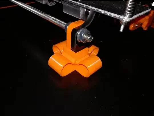

I have an Anet A8 and these vibration dampers do a great job:
Thingiverse: Vibration Damper for Anet A8
Sojtin
  • 129
  • Hi @Sojtin I am on the edge on deleting this answer. As it is getting upvotes I will keep it. The issue is it cannot really stand without the link to thingiverse. That model could one day be deleted. See stackoverflow.com/help/how-to-answer for more information – StarWind0 Jan 24 '19 at 00:00
  • Is this a damper or a spring? What dissipates the energy? – 0scar Oct 20 '20 at 11:06

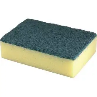

I had a similar problem, the neighbour started to complain. I solved the problem by putting scourers under the table where my printer was placed on top of.
They are mildly effective, but very cheap. They were 7 cents a piece at my local supermarket.

CNC Kitchen performed measurements especially to avoid noise being transferred to other rooms, the result is that placing the printer not on elastic feet, but on a single slab of concrete which is placed on top of foam is the best solution and reduces the noise significantly.
