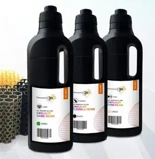

I'm planning to make an LCD Resin printer. I'm still learning and I found out that I need daylight resin (which hardens when white light comes from the LCD).
If I search for "Daylight resin" on Google, the only "useful" result I find is for Photocentric.
Photocentric Resin
Photocentric sells Daylight resins and the prices seem to be good too; however, I'm trying to search for alternatives. I'm not interested in something cheaper, I'd like to choose a resin which has more colors. Photocentric's hard resin only comes in cream/green/gray colors. I would need at least white/black/transparent resin.
Is it the only option we have? Are there any other manufacturer out there which produces Daylight resin/LCD-hardening resin with a variety of colors?
