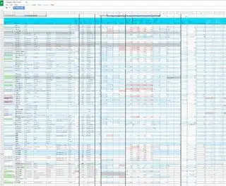

If you want to see his results, he has created a HUGE Wall of Data of all the filaments he tested:
Data table
