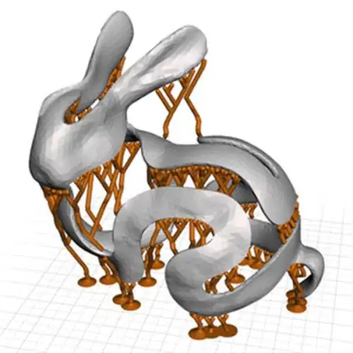

dual extrusion rabbit
The rabbit in this image was being prepared for two colors. I've seen the video but cannot recall why this image was presented, as the other pieces were eventually incorporated during one print. It's possible this image represents a single color print, based on the supports, but it is indicative of a partial process during the creation of a dual extrusion print.
