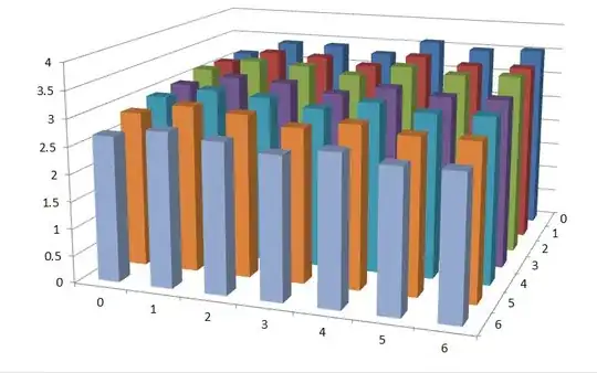

Here is a visual of the leveling grid (but upside down to make it easier to view):
Inverted visual of the leveling grid
Naturally I DO NOT enter G28 after the scanning.
I enter G0 Z1 to down nozzle almost to table. But when I enter for example G0 X25 Y30 and look at level and then I enter G0 X150 Y150 I see the big difference between nozzle levels relatively to table. So it seems that height compensation does not work. I expect that Z axis would lift up or down depending on auto-leveling results but Z motor do not work when I move X/Y.
