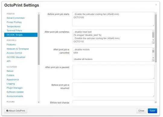

Another answer that does exactly what you want involves the use of a print server. A print server is an application that runs the instructions to the printer over a USB connection from another device, this can be your computer/laptop, or a dedicated Raspberry Pi (a small and affordable computer). One such application described here further is OctoPrint (this may very well be done with other applications, but this needs to be checked first!), this print server application allows integration of many third party plug-ins next to the extensive feature set it already has out-of-the-box. One such feature is GCODE scripts (intently spelled this way to match the option in the Octoprint settings menu); this screenshot shows some details:
GCODE scripts menu options item
As can be seen from the image, there are specific "events" available to process G-code commands at specific event occurences like e.g. just before the print starts. You could use that envent to insert your leveling commands.
Please note that in the image you will find strange G-code commands like OCTO100 and OCTO110 which is a feature of the plugin called "GCODE System Commands" which allows running shell scripts to schedule the fan. I just kill the power to the fan when the printer is idle to get rid of the noise when the printer is just idling, the fan is only needed when the hotend is at elevated temperature.
