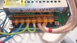

Power supply output grounding
While taking some measurements on my machine, I discovered that the negative side of the output of the 12V LED power supply I am using was not connected to ground inside the power supply as I expected. This presents a safety hazard. So I added an additional wire from ground to the spare negative output terminal of the power supply.
Correctly grounded power supply
