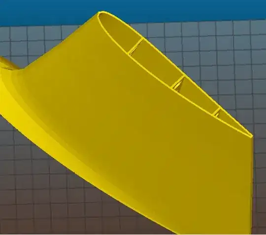

I have this wing design that I want to print:
wing

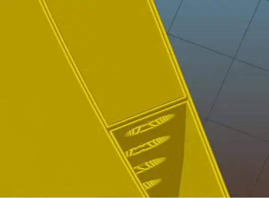

You can notice that its walls have a thickness, which is 1.0 mm. I want to print it so that the perimeters are inside that thickness. Here is the wing sliced with 1 perimeter and 0% infill:

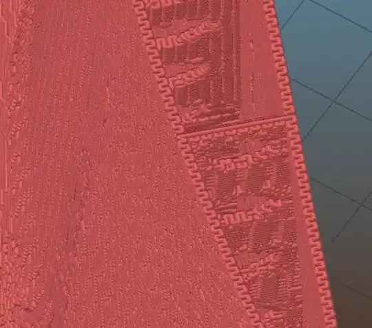

You can notice a gap between the perimeters. That gap is what I want filled and not the perimeters in the image. With 0 perimeters and 100% infill I got this zig-zagged line:
Zigzag filled gap between perimeters
I want the gap to be filled; but, I don't want it to be zig-zagged like in the image. I want it to be smooth like the perimeters in the other image.

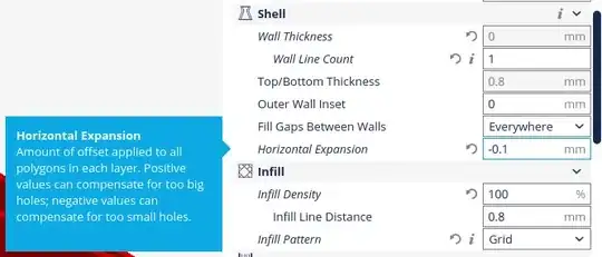

I found a great solution!
In Cura, there is a setting under Shell called Horizontal Expansion. What this does is it controls the distance between the two perimeters. A negative value in this field will make them come closer together, thus removing the gap between them.
Horizontal Expansion settings dialog
I found that -0.1 is the perfect value for 1 mm thick walls like the ones in my design. So I set it to -0.1, then set the infill to 100% because in some spots the thickness is a little bit more than 1 mm, so the infill closes the gaps in those places. Here is the result:

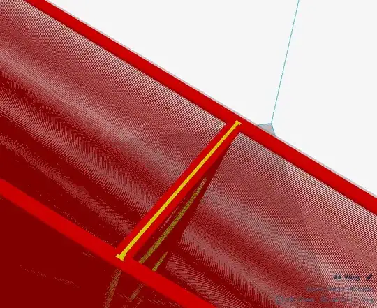

Image of Solid perimeters
You can see the perimeters are now sticking to each other and there is no gap between them. The result estimated weight is 71 g, which is a quite good reduction from the estimated 92 g when not using horizontal expansion.
