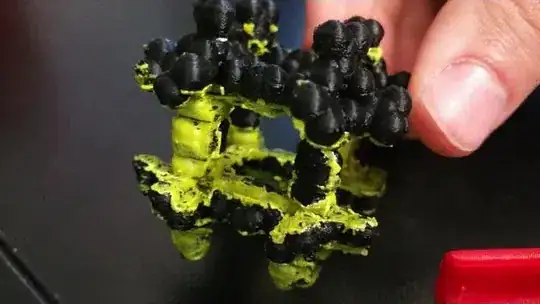

Sometimes supports are very difficult to remove (physically) when I print with ABS. The image below, from Thingiverse - MOF-5 unit cell, is after significant effort to remove the yellow ABS supports from a black ABS model.
Yellow ABS supports removed from black ABS model

  • PLA is not completely immune to acetone. It's unlikely you'll have any success trying to dissolve ABS supports away from a PLA model. – Tom van der Zanden May 21 '17 at 08:30
  • PLA supports come off a lot easier than ABS supports. Have you tried printing the object with just PLA? – bill_080 May 21 '17 at 12:57
  • Don't bother with ABS supports for PLA models… the two don't adhere well, and the acetone bath will bleach the PLA as well as staining it with whatever pigment is in your ABS support. I tried a few times and it never ended satisfactorily. See my answer below for a recommendation/alternative to PVA. – Dustin Wheeler May 22 '17 at 16:09
  • @khaverim Have you fixed this issue? i'm seeing that your supports are too heavy, try to use a less population like 50% or 40% of the infill support, also separation will help to avoid to get adhesio to the walls. – Fernando Baltazar Aug 09 '18 at 16:56
