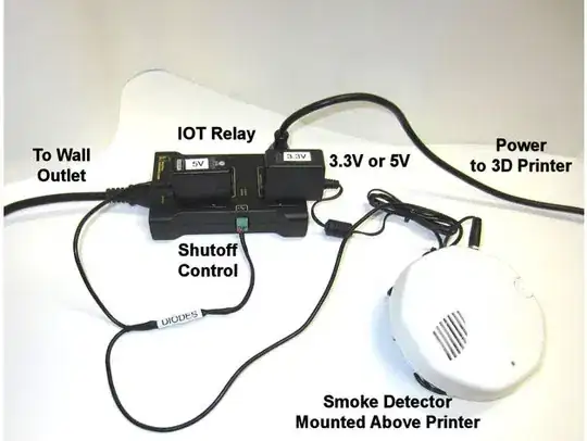

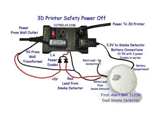

I'm going to set this up for my printer: 3D Printer Safety Shutdown - Smoke Detector
3D Printer Safety Shutdown - Smoke Detector - Photo
3D Printer Safety Shutdown - Smoke Detector - Diagram
Looks like a great solution for preventing fires.
