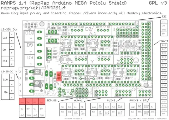

With RAMPS (see handy diagram RAMPS 1.4 RepRap Arduino Mega Pololu shield),
the 4 pins are commonly labelled (starting from the one nearest the power-supply end of the RAMPS board):
2B 2A 1A 1B
It means coil 1 and coil 2, each of which has ends A and B. I find this unclear because it could just as well have been numbers for the coils, and letters for the ends (if you wire it that way it won't work). So be sure you have continuity (maybe 15 ohms or so) between the wires you connect to 2B and 2A, and between the wires you connect to 1A and 1B.

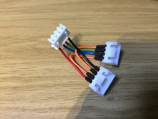

For some unknown reason, everywhere everybody is saying that Z stepper motors need to be connected in parallel... And this was always the only obvious way, until recently some people started to connect these motors in series.
And I personally started to believe the right way is to connect them in series.
All stepstick drivers are some kind of current limiting devices (you could read more about chopper mode). It is all about current. Connecting in series will guarantee that both motors receive the same current in all situations. And as result you could expect the same behaviour from both of them.
The bad thing when they are in parallel, is that the motor with the bigger load will get more current and as a result the other one will get less current and could skip steps. Of course, in an ideal situation, this should never happen but don't forget about Murphy's law ("whatever can go wrong, will go wrong").
One more thing - why did I change my wiring and connected my Z motors in series: At some moment I found that one Z motor was disconnected but the other one was working and this resulted in a broken printer geometry. When Z motors are in series and if one of them fails or disconnects, the other one will not work either. You will get always synchronous operation from both of them!
I made this Z splitter that works fantastic:
Z splitter

  • There are two coils in each stepper motor driven by different pair of wires. This is a really helpful contribution how to connect 2 z-axis motors to a mainboard with only 1 z-axis socket. – László Gönczöl Apr 15 '19 at 10:54
    The wiring in this splitter pairs are red-blue and green-black, so the Splitter puts the "lower" pins on one circuit, and the "upper" on the other. As a result, step commands from either circuit affect the motors synchronously. To minimize errors, it would be a good idea to make both branches connecting to the splitter as even in length and as short as possible. – Trish Apr 15 '19 at 12:04
