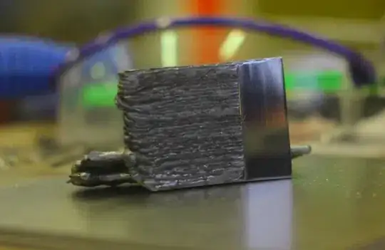

Liquid metals tend to have a conflict between "Staying where you put it" and "bonding with the previous layer." In order for deposited metal to fully bond, the interface material needs to reach the melting point so a true fusion weld occurs. And in order to supply enough heat to remelt the interface without an additional heat source like an arc, the deposited molten metal needs to be very hot. So it will tend to run while it cools. High density and high heat capacity makes it run fast and cool slowly.
Pretty much every DIY metal 3d print (such as made by wire-feed MIG welders) ends up looking something like this:
enter image description here https://3dprint.com/29944/diy-metal-printing-garage/

It is possible to "FDM-style" 3d print filament/wire made of metal alloys that have a wide range between solidus and liquidus. It has been done using solder and similar alloys. However, between the warping stresses, poor layer bonding from inadequate interface re-melting, and use of soft low-melting alloys, the resulting printed parts will usually end up being weaker than if they had simply been printed in a strong plastic. For example, PEEK is nearly as strong as aluminum, and carbon fiber or fiberglass composite plastics can exceed metals on various performance metrics. So what's the point of printing with weak, brittle metal alloys?
Over the years, lots of people have tried FDM-style metal printing, but no one has found it worthwhile to pursue in the long run. More typical DIY metal printing approaches like 3D MIG welding following by cleanup machining will produce better results.
