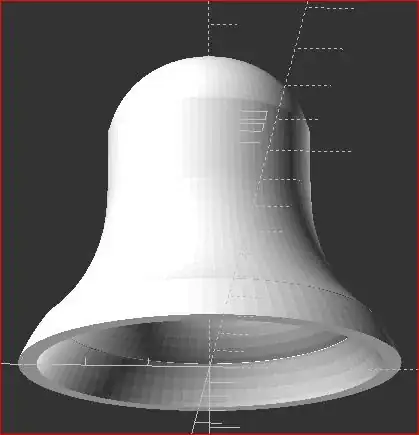

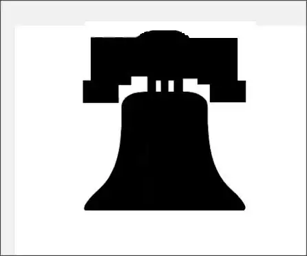

The overall goal is to create a print of the liberty bell. No clapper is needed. The support beam is not needed. I am just looking to mimic the outside shape of the bell. After an application of Google-fu I found this image. It has been cleaned up and cropped a bit.
In OpenScad the surface function was applied to the png to generate a height model. I subtracted out a few cubes, and eventually got it down to a layer of about .1 height.
My Evil (pun intended) plan is to get it down to a 2d model. Then by shifting a copy of model from itself, and subtracting the two. That should leave just the curve. Then rotate_extrude the curve to generate the actual bell at the desired thickness.

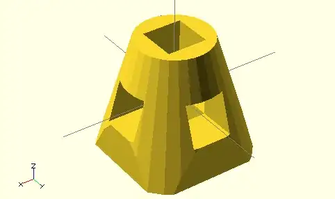

Note that the part image below is centered in x, y, z and the cut/projection action takes place at the z = 0 plane:
sample model image

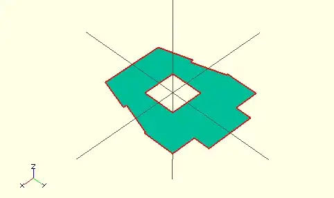

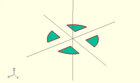

When the function is applied to this model, the result is a non-contiguous 2d image:
projected cut image

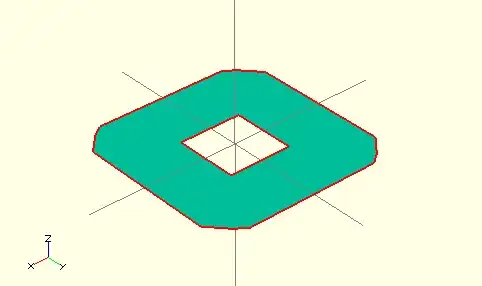

When the cut parameter is ignored or set to false, the image which results is effectively an orthogonal shadow of the entire object, rather than a selected slice:
flat shadow image

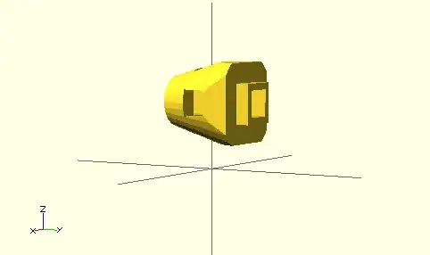

It gets better, of course. In OpenSCAD, the translate, rotate and scale functions apply. One can tip a model over, resize it, spin it around, combine with the cut parameter and get any combination of 2d image from the original model:
rotated model image
shadow rotated model
