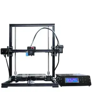

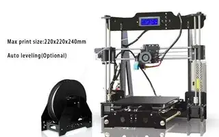

Here is what the two printers look like
P802 P802
X3 X3

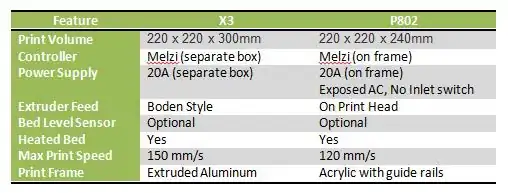

Here is a comparison of the features enter image description here
Here are my overall impressions:
  • Both printers are kits and have their assembly challenges
  • The X3 is often a little bit (10-20%) more expensive
  • The X3 frame is very rigid. I have heard the the P802 is also rigid.
  • Acrylic is not as durable long-term (it cracks). There are Acrylic parts on both printers; but, the Acrylic frame on the P802 would concern me more.
  • The bed on the X3 can wobble and the P802 doesn't look like it would. (Note there are several available modifications to fix the X3 wobble)
  • The Boden extruder on the X3 makes the filament pull consistent; but, it can make the filament more difficult to feed.
  • The External Controller box on the X3 can make the printer more difficult to move and it can take up more desk space.
    The biggest negative (and likely a show stopper) on the P802 is the unprotected Melzi, Exposed AC connections, and no power switch.
