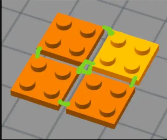

Actually the answer is yes and no. So I had to print 12 of the same small objects for a science experiment. Just some rocks I made from domes with some displaced faces, anyway my printers minimum wall width is 0.5 mm. The objects were 2 cm³. The first print failed because of them being disconnected but then I connected the 12 items by 1×1×5 mm solidified cylinders in blender and ran it through my cutter and it printed no problem. Afterwards I jusy clipped off the cylinder and was good to go. Just make sure you're object is connected at every point facing another. Based on your picture it should be connected something like this:
  • Are you saying that your printer will not print multiple STLs as one job, they must all be connected and imported as a single STL? – Davo Jun 23 '20 at 21:30
    Welcome to 3DPrinting.SE. Thanks for sharing your thoughts, but this doesn't answer the question. Furthermore, parts not being attached to each other and failing because of that is something I've never seen or experienced. Printing multiple things on the build plate and wether they are connected or not is not related. – 0scar Jun 24 '20 at 05:46
