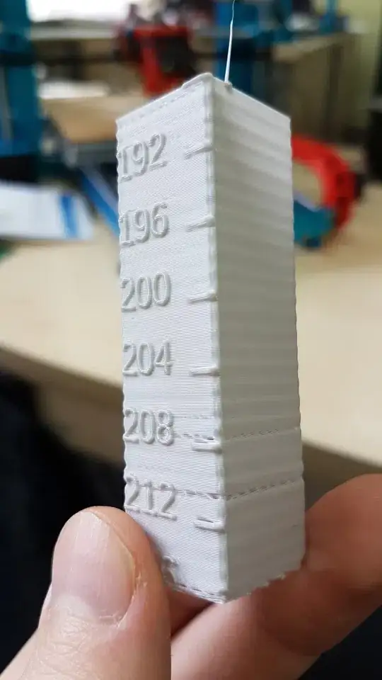

When I print with my mElephant 3D printer from Makeblock, the prints come out with waved walls like in the picture below. I am using PLA filament from https://makeblock.lt
3d-waves
What I tried
I tried changing temperatures 190-220, tried to change the flow rate. Also checked if the bolts are not lose. Everything seems good.

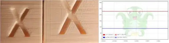

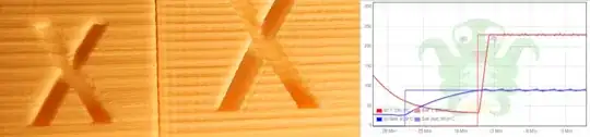

I had the same problem with ABS, but printing different test objects I found out that the distance between the wavy structures depends on the cross sectional area of the object. Printing the testcube in 70.1% (1/sqrt(2) times of the original size) takes half the time per layer and the distance between two grooves doubles. I was printing ABS with 0.1 mm layer height and the simple bang-bang heat bed controller. The temperature is clearly wandering for 4° with a period of aproximately 2.5 minutes, which corresponds to the groove distances. After changing to a PID controller for the heated bed the temperature stayed within 0.1°C and the problem was gone. Several hundredths of a millimeter thermal expansion of the heated bed can have substantial impact at 0.1 mm layer height!
You can enable the PID controller for the heated bed in Marlin or Skynet firmware by enabling (removing the //) here:
//#define PIDTEMPBED
and disabling (putting // at the beginning of the line) here:
#define BED_LIMIT_SWITCHING
in Configuration.h. Calibration of the PID controller can then be done with the GCODE Command:
M303 E-1 S90 C8
for 90°C. I had to preheat the heated bed before, otherwise the calibration would run into a timeout. The command will return parameters for the PID algorithm. The values can then be applied by the
M304 P579.01 I100.87 D586.0
GCODE command (here for example values). Everything can then be saved to the EEPROM with
M500
Bang-Bang controller: Bang-Bang controller
PID controller: PID controller

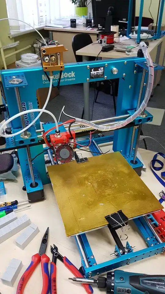

Repeating patterns like that usually stem from issues in the Z axis. This is likely caused by bent screws which in turn cause the X axis to move around. Are the top of the threaded rods constrained? If they are, an easy fix may just be to let the top of the threaded rods float around by removing the constraint. Most Prusa i3's use 5mm threaded rod for the screws and 8mm smooth rod, does your printer use the same setup?
If your printer has 8mm (or 5/16") threaded rod you could try to get some that are straight or the better solution would be to get the 5mm threaded rods and just print adapters to hold the 5mm nut inside the trap. This would require new couplers (aluminum or rubber/plastic hose), 5mm threaded rods, nuts, adapters (printed) and a small change to the firmware. This works because the 5mm rod is more flexible than the 8mm smooth rod and less likely to force the carriage around.
If you already have the 5mm threaded rod/8mm smooth rod then I would look to make sure your X axis is tight and does not move around on the Z axis smooth rods.
This would be easier to point out if you include a picture of your printer.
Edit:
If your printer is the mElephant from Makeblock then I would try removing the bearings at the top that constrain the threaded rods and try the print again.
tjb1
  • 2,090
  • 14
  • 26
  • Thank you for your detailed answer! I updated the question with images of my 3D printer. – gpson Feb 09 '17 at 14:40
  • It seems I edited my answer the same time you added the picture. I would try removing the bearings at the top that the threaded rods are held in if you can easily do that then try that print again. – tjb1 Feb 09 '17 at 14:41
  • removed top bearings, problem persists – gpson Feb 09 '17 at 17:08
  • Do you see noticeable movement in the threaded rods? – tjb1 Feb 09 '17 at 20:24
  • @gpson The bearings are part of the problem, not the complete solution of problem (but should be left out). Your steppers have integrated lead screws, any mis-positioning of these lead screws leads to x and y movement of the screw when advancing up or down. You need to separate this movement. One solution is using separate lead screws and springy couplers (but these introduce also problems). A better solution is to remove your lead screw nuts and print a sort of a lift platform that contains this nut, then you separated x and y movement from the lead screw completely. – 0scar Apr 09 '18 at 17:53
