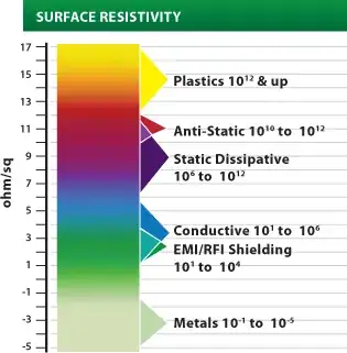

PLA itself falls in the category of non-conductors, with a resistivity ($\rho=R\frac A l=\frac 1 \sigma$) in the order of $10^{16}\ \Omega \text m$ (see here), similar to other plastics. Following image gives an idea of the values of resistivity for usual conductors and isolators, insulating materials have resistivity greater than $10^9\ \Omega\text m$, conductors have it smaller than $100\ \Omega \text m$ (copper is about $10^{-8} \ \Omega \text m$):
