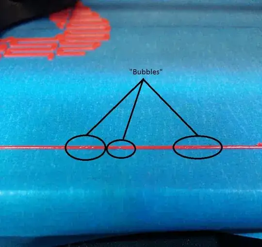

I've noticed this on almost ever print I've ever had. On the initial first line that clears the extruder nozzle tiny little bubbles/craters seem to form on the line. While I don't think these are causing any issue with my prints I'm curious to know the reason why they form at all.
Is this due to water absorption in my filament that turns to steam, which then bursts through the molten plastic? Is it due to air bubbles in the filament that are cause by the manufacturing process of the filament? Or is this more an indication that my nozzle is damaged or clogged in some way?
Bubbles in extrusion
This image was made using ABS plastic and a heated build plate. I've noticed these same 'bubbles' appearing using PLA, and Nylon.
Edit: Nozzle temperature 240°C, build plate temperature 150°C, Nozzle diameter 0.4 mm, filament diameter (measured 1.75 mm) retraction distance 1.7 mm. Using the Makerbot Desktop Slicer.

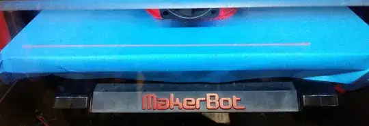

The first line that my printer extrudes, where I'm seeing these 'bubbles' is a nearly full line. Makerbot starts from the right side of the image, extruding to the left.
Single line extrusion on printer bed

  • Please provide the head temperatures, feed rates, nozzle diam, etc. What I see in the picture looks more like a startup problem of the nozzle feed "chamber" not being completely filled yet. Try preheating the head and manually forcing the filament in so that a couple inches are extruded before initiating the print code. – Carl Witthoft Jan 19 '17 at 14:45
  • The last 10 prints i've done seem to be looking like the 'bubbles' occur more often right at the beginning of the print/ first line. Would this be more indicative of a retraction setting issue do you think? – Diesel Jan 20 '17 at 17:02

Oh yeah, that's simple. You are printing too hot and are literally boiling the plastic. Else you have water. However if it was water you would hear Crackling as it printed. If it is too hot you will not hear nearly as much. I am 87.341% sure you are printing too hot.
Looking at your printing temps you are without a doubt printing too hot.

    I'll give it a try at lower temps, (was at 240C for ABS). I've been raising the temp to try and improve the top layer/last layer thinking that I was running a bit cold. Might have to open another question on that instead now :) – Diesel Jan 24 '17 at 17:25
  • In those cases you want to lower your solid infill speed. That way it goes slower on those layers and adheres better. Speed and Temp are always in opposition. – StarWind0 Jan 24 '17 at 17:54
  • Very useful information. This is what was causing my bubbles so if the feedrateis too slow it will get too hot and be boiling. – Keith Bybee Oct 30 '17 at 22:37
In my experience, bubbles like this are caused by the filament absorbing moisture, which then cooks out at the high printing temperatures.

  • Would you expect a new roll of filament to have water absorption? Or would you recommend cooking/drying out a new roll? – Diesel Jan 20 '17 at 16:58
  • If the roll didn't arrive in an airtight bag, with desiccant, I would expect water to have been absorbed, yes. – Davo Jan 20 '17 at 20:29
  • Probably not water then, It's a new roll, air tight sealed with a desiccant in the bag. – Diesel Jan 23 '17 at 15:19

I have spent many hours testing my Anet A8 to resolve the popping issue. The symptoms are similar to yours, Diesel. Both ABS and PLA, different manufactures, good packaging, as well as various sizes of nozzle, are producing bubbles.
I was experimenting mainly with two variables: nozzle temperature and retraction length. Other related parameters I kept fixed:
  • Material: ABS
  • Nozzle size: 0.5 mm
  • Retraction speed: 45 mm/s
  • Travel speed: 50 mm/s
  • Print speed: 40 mm/s
Retraction length
Originally it was set to 4.5 mm. I found it to be impacting the amount of popping significantly, especially in the range of 0.5 mm to 2.5 mm. The optimal value appeared to be in my case 0.8 mm. A lower value would produce even better results in terms of surface quality, but would also start producing oozing.
One important side note is that at the retraction length of 4.5 mm, leaking of the material during idle moves was significant and was becoming even a bigger contributor into gaps in the print strikes (immediately following the idle moves), than popping. This observation is kind of contradictory, but I am making no mistake here. Too large of a retraction apparently may have the inverse effect on leaking/oozing.
Nozzle temperature
Originally was set to 250°C. 260°C produced significantly worse results. 240°C is where I stopped.
Based on some other research, including talking to my friend who successfully uses the same plastic at 260°C, I made the conclusion that the quality of my print head assembly is not perfect, and that it is the main cause of the problem. By finding the perfect retraction/temperature combination I simply mitigated the air sucking in the head, which could be not happening at all if I had used a better quality extruder and nozzle in the first place.
