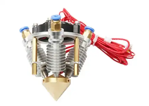

The printer being a kit came with the print head completely assembled as shown in the picture. Printer Head-hotend

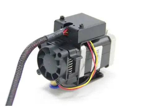

Not shown in the picture it also had the Bowden tubes in place. It also came with the extruder assembled as shown in the picture. The extruder
So aside from wiring and mounting these pieces the only thing I did was cut a clean edge on the Bowden tube and connect that to the extruder.

    A hotend like this should *always* have 3 filaments loaded, or else molten plastic will clog up the unused inputs. Are you using only one colour (and leaving the others unused) by any chance? – Tom van der Zanden Jan 14 '17 at 22:33
  • Yeah, I only have one loaded... I imagine I have to clean it out now that I heated it up with only one color? What would be the best way to go about that? – Evan Jan 14 '17 at 22:36

  • Still having trouble? Can you see if it is extruder gear slipping against the filamen? Or is the extruder motor jumping back and forth? If you can see the extruder gear, paint it striped with a marker. – Gunslinger Jan 26 '17 at 09:09
  • @Gunslinger Yeah, I cleaned out the hot end best I could and it was still difficult to push filament through by hand. Hooked up to the extruder it worked of the extruder took small steps but there was a a delay between filament in and filament out. The extruder gear was not rotating when it was slipping so it is gripping the filament well enough – Evan Jan 28 '17 at 13:38

  • @JKEngineer Yes, I did try just slowing everything down but it didn't really help, I think there might be a manufacturing Defect in the head and have ordered a one color hotend to get me by while i work with the company to get a replacement – Evan Feb 08 '17 at 15:17
