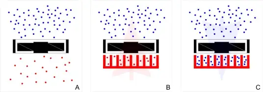

Getting hot air from the radiator is definitely wrong idea because of few reasons:
  1. hot air can damage your fan (as they are usually not heatproof). Cold air cools the fan
  2. cold air is denser so fan can suck more cold air than hot air so cooling is more efficient (fig A)
  3. in terms of plug of radiator (with dust) it's much better to try to push cold air into plugged fan (fig C) than to suck the air from it (fig B). When flow is decreased there is higher possibility to damage the fan as it doesn't cool itself
Of course we are talking about 3D printers with small plastic fans. Please notice (almost) all fans construction: they are designed to get air from the top of the fan and push it to the bottom (this construction prevents damaging/plugging fan motor by dust)... and their mounting wholes (or clips) are usually... naturally suggesting to direct air to the heatsink)

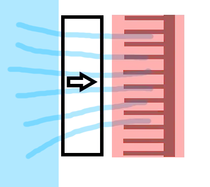

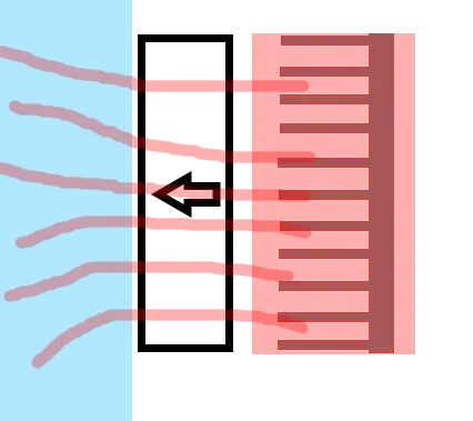

In the case of 3D Printing, it's going to be faster to cool the radiator by blowing out the heat from the source.
The idea is that you're trying to get rid of as much heat as possible in the quickest means possible. By blowing away from the radiator, you're allowing the ambient temperature to cool the hot air being blown out.
If you were to blow the ambient air towards the radiator, the blown air will warm slightly as it is overwhelmed by the heat of the radiator. Even though the ambient air may be cooler, it will take more time to cool off the radiator.
Example of bad airflow, which will take much longer to cool the radiator: enter image description here
Example of good airflow, allowing the hot air to be quickly cooled by the ambient temperature of the build space: enter image description here

  • I don't dispute the conclusion, but I think its misleading to talk about ambient temperature. All that matters to the heatsink is the air passing its fins. Both cases mix 'new' air with the already heated air. – Sean Houlihane Jan 10 '17 at 08:37
  • @SeanHoulihane I see what you're saying and I think I agree more with darth pixel's answer. I was coming from the perspective of a machine with a heated build plate, where the ambient temperature is still about 90°F (more if enclosed). – tbm0115 Jan 10 '17 at 15:15
