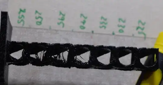

Below about 215°C, extrusion is borderline non-existent. I printed at 225°C with a fan, and it extruded kind of OK, but adhesion was poor. 240° without a fan seems a bit on the hot side (see photo). Even 255°C seems to extrude OK without burning. There is no smell I can observe (but I have a cold). It burns with a small blue flame, and minimal smell (kind of like natural gas).

255° to 225° heat tower, seems different to the ABS i've used: enter image description here
