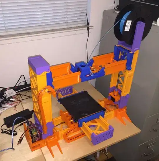

3D printers obviously do not print themselves. 3D printers are sometimes used to make parts for other 3D printers, and this is what is meant by "self-replicating" 3D printers (which is a bit of a misnomer, considering that all designs require a substantial amount of non-printed "vitamin" parts).
A printer that is able to produce many of its own parts is the RepRap snappy, which (as the name suggests) consists of plastic parts that - while they each fit within the build volume - snap together to make up the larger parts for the printer.
RepRap Snappy, from the RepRap wiki, GNU Free Documentation License 1.2

    So, replicating printers mean they print components of a 3D printer but assembly of these components is still a separate process? – user91579631 Dec 26 '16 at 11:47
