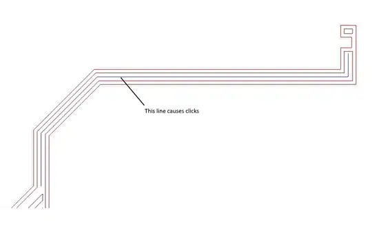

I have Prusa i3 derivative with MK8 extruder and Marlin 1.1RC8 as firmware. I already reduced the default speeds as well as the accelerations. But sometimes when trying to print with BQ PLA filament (220°C), mostly during filling areas, my extruder clicks. The below screenshot of Slic3rs Layers view shows the clicking "lines".
What settings I need to change to avoid the overextrusion in this case?

    Are you sure it clicks exactly when retracting? Clicking mostly indicates extruder is unable to advance filament. In your case if it sounds when more filament is required (like filling areas), then you may try to reduce printing speed in such areas or increase nozzle temperature. – Mikhail Z Dec 13 '16 at 15:11
  • You are right. On a different object it becomes obvious that the clicking occurs when performing solid infill, even on a long "line". I'm using Slic3rs default values for the speed, so 20mm/s for solid infill (normal infill 50mm/s). – Thomas S. Dec 14 '16 at 19:33
  • If reducing speed won't help, then there is something else blocking smooth filament extrusion. With PLA you are most likely using cooler. Try reducing cooler speed for areas with 100% infill. Otherwise look at @rwinscot answer. – Mikhail Z Dec 14 '16 at 21:46
  • First 220c for PLA? You must be running at record speeds! But really a video would be a lot of help :-) – StarWind0 Dec 14 '16 at 22:41
  • @StarWind: no, this PLA is specified to use 220°C. I'm using speeds of up to 50mm/s for inner perimeters. – Thomas S. Dec 15 '16 at 16:06
    @ThomasS, will the print continue fine afterwards? If it does, this may simply be the issue of a too large nozzle trying to squeeze infill into a gap smaller than itself - something many slicers struggle to handle elegantly. – Tormod Haugene Dec 16 '16 at 07:52
  • Yes, the prints are just fine. – Thomas S. Dec 16 '16 at 09:25

  • This is a very generic answer that is not specifically addressing the problem. Tormod and Davo are on the right track. The nozzle tries to squeeze in a line of infill in between two tightly placed perimeters, this causes extra friction as the molten filament does not fit in the left over space, hence the skipping. – 0scar Feb 25 '19 at 22:17
Try reducing to just two perimeters, and let that blue area be calculated as infill. This may give you a zig-zag infill instead of a straight, oversized bead.

I've tried to reduce the "Extrusion multiplier" from 1 to 0.95, but that caused gaps. Now I've minimized the clicking by setting the Slic3r option "Infill before perimeters" on the "Print Settings > Infill" page.
