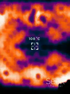

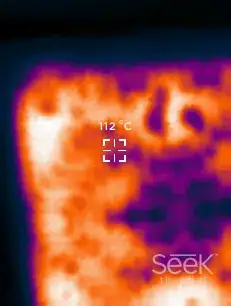

Update: Build Plate Thermal Images w/plate set @ 115C
Center Plate Front Corner

  • @tbm0115 It could definitely be the heating on the print bed. I don't know how consistent they typically are but I have added an image to my question to show the inconsistency of mine. I don't think the plate is bent because other materials print perfectly flat and the bent parts placed back on the surface appear bent. – jmb2341 Nov 01 '16 at 17:44

  • The images are great! At first glance it seems that you have some dead coils in your HBP. However, it doesn't quite make sense because I think most HBP coils **start** in the center. So, you would think if the center was dead, the rest of it would too. I might recommend reaching out to @RyanCarlyle on this one. I'll keep poking around for better alternatives, but at this point I think you might be looking at replacing your HBP. – tbm0115 Nov 02 '16 at 14:46
