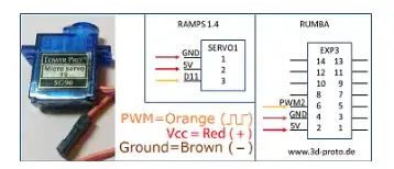

I have only installed the hardware for now (5 V servo) connected to Ext. 3 (EXP3):
  • Pin 2 (+5V);
  • Pin 4 (GND), and;
  • Pin 6 (PWM),
Servo and RAMPS 1.4 and RUMBA connections
RUMBA EXP3 pinout
but I cannot move it with the G-code command M280 P0 S180. I have no idea where to put my hands on firmware to get this going. However my ultimate goal is to set the ABL.

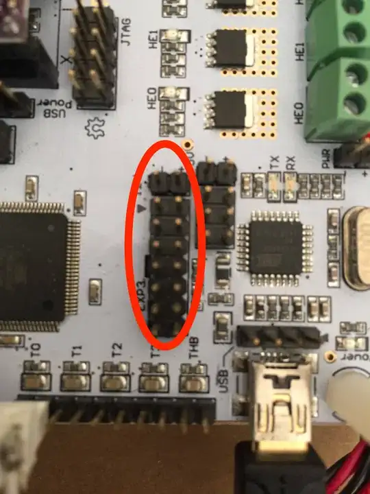

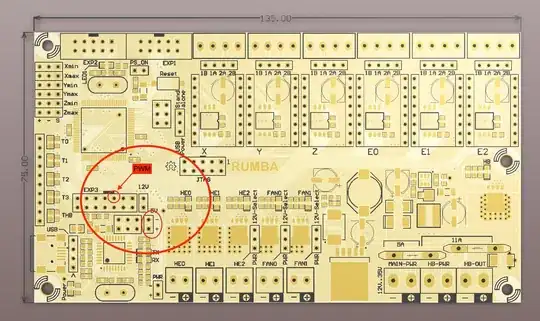

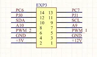

My issue about the servo not moving was caused by a wiring mistake. The Exp. 3 has 14 pins has per this diagram.
However when phisically looking at the board, what you see is this: enter image description here
I took the first 2 pins on the right of such connector and the 3rd one of the first row thinking that I was connecting pins 2-4-5 of Exp. 3. I was wrong, because the first 2 (1-2) pins are not part of Exp. 3.
The right way to connect the servo is as following: enter image description here
Then use PWM1 (pin 5 Ext.3) I decided to leave trace of this issue and the relevant solution for someone that may experience the same issue.

  • Thanks for your answer. The main issue I am experiencing is to get the servo to move. If I connect it as per my question it does not move. Reading your answer looks like I should connect it to 2, 4 and the PWM to 5 and then use Servo0 in the config and in the Gcode. Is this what you mean? I have added a pic in my question showing the ext.3 diagram. – FeliceM Oct 31 '16 at 07:53
  • Yes, the best I can tell you should connect the signal line to pin 5, which is pwm1. – Jexoteric Oct 31 '16 at 23:40
  • I have done everything as per your answer. I had also to activate the servo support where I have defined the SERVO NR 1. I have checked the servo functionality with an arduino board and it is fine. However when I send the Gcode M280 P0 S90 the servo does not move! Not sure about what to do. – FeliceM Nov 01 '16 at 12:24
  • What angle is your servo currently at? If it is already at 90 it will not move, you can try another angle to check. Also are you sure the servo index starts at 0 on that board? Try M280 P1 S80, and M280 P0 S80. Between those two commands it will check both of my suggestions. Other than that I think I've gone as far as I can to help without having ever used the Rumba board. – Jexoteric Nov 02 '16 at 01:56
  • Thanks for your help. Since I had to defined the number of servos in the section Servo support, I used 1, if I give a P1 it returns "servo out of range" while with P0 nothing is happening. Not defining the servo number, the firmware does not compile and returns the error "define number of servo". I have tested the servo again with an Arduino and it is fine. I tried both pins 6 and 5 ext. 3, but it does not move. If I run G29, the printer execute the ABL but the servo does not move. I moved it manually in an intermediate position to avoid having it already in the end position. Nothing! – FeliceM Nov 02 '16 at 05:54
