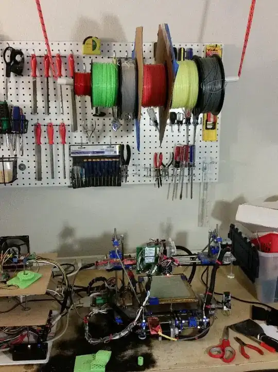

Edit: From some of the answers below, it seems that maybe the travel of my X carriage back and forth could be why my spools keep getting tangled. -- It looks like many people have their spools at about 90 degrees from mine (rotated relative to the Z axis of the printer), so that the travel of the X carriage won't have that affect. -- Also guides, etc are probably a good idea.
Here's my current setup for reference (filament removed): enter image description here

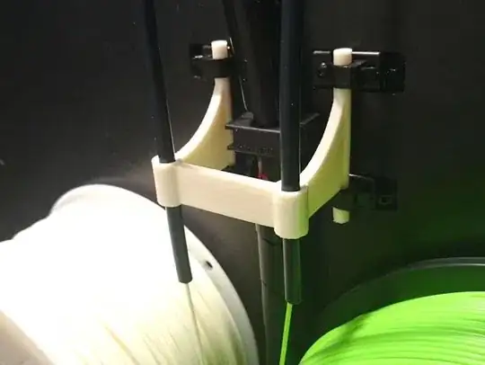

Though not technically tangled your filament can also get stuck if the spool does not properly unwind (and the filament gets wrapped around the axle that supports your spool). Make sure your spool can rotate on its holder easily (ball bearings are not needed, a simple round axle is enough). Make sure that your printer pulls on the middle of the spool, and not sideways. If necessary, could build a guide (such as a small ring or tube for the filament to pass through) to keep it centered.

  • Yeah, my spools can rotate freely, but I think I will need a guide, and also I'm going to consider remounting them at a 90 degree angle on the Z axis -- (I'll edit the post to include a picture). -- Is there... like an equivalent of a one way "valve" for filament? -- maybe something that ratchets? -- Like something that, will let me pull the filament off the spool, but if it becomes slack, will not let that slack translate back up to the spool? – BrainSlugs83 Oct 08 '16 at 19:43

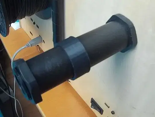

I had the same problem with my FFC dual.
Consider using some kind of retaing clip to hold the spool in place, so it doesn't move back and forth on the post. This spool holder worked for me:
Another thing that can help is to make sure you are pulling the filament from the middle of the spool. This worked for me:

  • Interesting. Also the orientation of your spools -- like on the Z axis -- is 90 degrees offset from mine -- I was just thinking that that probably makes a big difference too -- as my X train moves horizontally, it's probably what's causing the filament to become overlapped!! – BrainSlugs83 Oct 08 '16 at 19:28
I used this solution, it makes a lot of sense, because I store the filament back in a box and the tip endup getting knotted.
