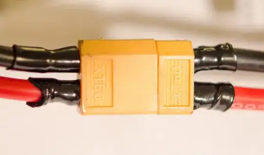

You might be able to use one of the connectors (Deans Ultra, EC3, XT-60/30, Bullet) that are normally used for RC models. They're made for very high currents. The XT60 connectors depicted below are rated for 60A continuous (well above what you'd need for any heated bed); their smaller XT30 cousins are good for 30A but less commonly available.
XT60 Connector (Photo by Mark Fickett)

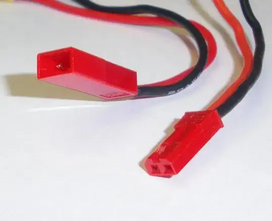

For your extruder you wouldn't need anything quite as drastic as an XT60, even a simple JST connector would suffice (though if you are going to source XT60/30's for your heated bed anyway, you might use them here as well).
JST Connector (Wikimedia Commons, Mike Mahoney)

  • Thanks @Tom, [I'm looking at these on Amazon right now](https://www.amazon.com/LHI-Female-Bullet-Connectors-Battery/dp/B00XBLLG5S/ref=sr_1_1?ie=UTF8&qid=1475890961&sr=8-1&keywords=XT-60), and I'm trying to figure out, are these solderable, or do they crimp, or what? -- What's the preferred way to attach wires to these connectors? Do I need a special crimping tool, or can I just solder them? – BrainSlugs83 Oct 08 '16 at 01:46
  • These are meant to be soldered. They have a semicircular tube on the end, which you fill up with solder. You should also pretin the wires. You then melt the solder that is in the tube, and insert the wire. [See e.g. this](https://youtu.be/L19amVtmP2c?t=5m50s) – Tom van der Zanden Oct 08 '16 at 08:30

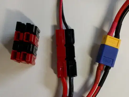

I agree with Tom's answer about RC connectors. Another good connector option worth considering is Anderson Powerpoles.
  • They're "modular" so you can use them to assemble connectors with multiple wires.
  • They crimp instead of solder (I really recommend the special crimping tool if you plan to use these regularly)
  • They're more expensive
  • No male/female, you use the same connector on both ends so you never run out of either male or female ends.
  • The small size is a little larger than an XT60 connector.
Anderson Powerpole connectors next to XT60
Both good options depending on your specific needs.
Chris Thompson
  • 1,051
  • Neat. -- I may look into these for a future project, or if the XT30 connectors end up not working out. -- How much current can they handle? – BrainSlugs83 Oct 10 '16 at 00:07
  • The size shown here works with 15, 30, or 45 amp spades. The special metal spades get crimped onto the proper gauge wire, then they snap into the plastic housing. They also have larger sizes and all sorts of accessories like panel mounts, etc. [More here.](https://powerwerx.com/anderson-power-powerpole-sb-connectors) – Chris Thompson Oct 10 '16 at 21:08
