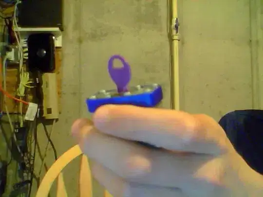

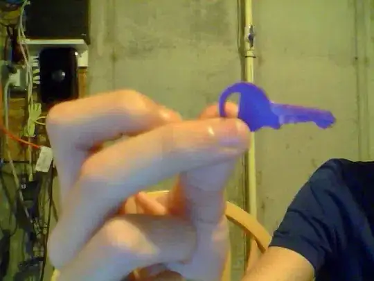

I 3d-printed a key.
When I put it in the lock the pins move but, when I go to turn it the key rips and the lock doesn't turn. I compared it to the real key and it's identical. Is there something I can do to make it work and not rip? Is there some filament that I can print it out of? I used ABS.

That is correct! Take your raw ABS plastic and try to bend and break it. Do it again with a few lengths. Pretty easy to break it right?
You issue is the material is not up to par with your goal. Your heavy duty lock takes too much force to turn.

Which direction are the layers being printed? If the layers are printing top to bottom (in relation to your picture) there isn't a lot of sheer force required to break the key when turning. If you make the layers print from left to right you might have better luck.

1I don't think it was printed like that. If it were printed like that there would be a lot of overhangs, which wouldn't have come out as well as we see in the picture. In the second picture, it doesn't look like it snapped between two layers, but instead the entire thing deformed. – Tom van der Zanden Oct 06 '16 at 05:46
