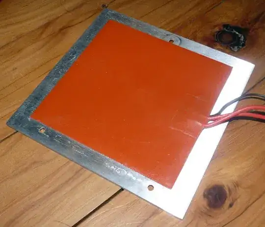

I am heating my 1 meter by 1 meter plate (yes those numbers are correct) (in progress long term project) of tempered glass with a silicone heater bed I bought as overstock on ebay. Silicone Heating Mat
Silicon bed
From Reprap Wiki
Silicone Heater Pad in sizes silicone heater pad Pros: Fast heating Reliable Most use mains voltage - DOESN'T require any amps from the 12 volt supply Very low height Easy to install (adhesive backed) Can be relatively inexpensive 12 V types can be run directly from the controller MOSFET without a relay Integrated thermistor Long life span Cons: Can be expensive - silicon mat (50€) plus solid state relay (16€). Mains voltage, but can be purchased for 12 V. Need GROUND line to aluminum bed for safety. Relatively high temperatures possible (safety problem if thermistor dies/falls off).
