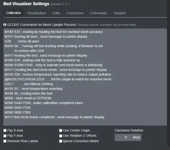

  • Did ABL Visualizer update.

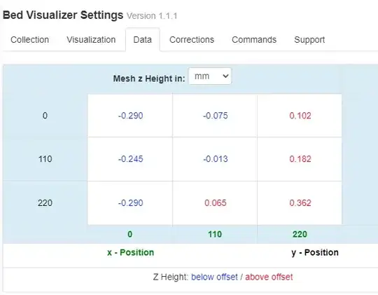

I'm having trouble getting my first layer perfect. As the front prints are loose and back prints are squashed to the build plate. Here is the first layer test print file.
If what I understood so far about ABL is correct, when printing with a uneven bed surface, the z height will be adjusted according the probed data. But in this test print looks like it is not being compensated.

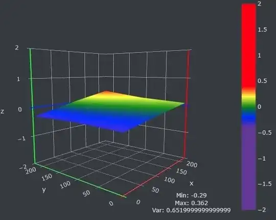

Below is how my visualized bed mesh looks like (with those fixed standoffs). enter image description here enter image description here enter image description here
Hansa G
What can be read from the visualization of your bed geometry is that the left side (when facing the printer) of the X-axis is lower than the right side, so your plate is tilted.

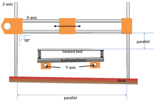

A possible alternative is that Looks like there is something wrong with your X-gantry, make sure the X-gantry is parallel to the bed, e.g. as seen in the following image:

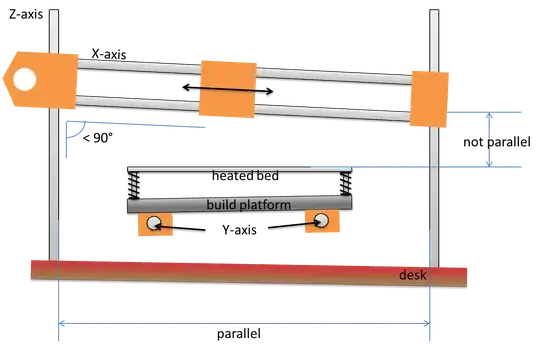

This could be a result of lack of maintenance, considering the printer is from 2018, the frame needs to be checked. At the moment, the right side is closer (high X values), so either your bed is higher on the right side, but more likely (as you use fixed length stand-off's) the X gantry is tilting down on the right side (when facing the printer) and therefore reporting closer to the bed as if the bed is higher to the right, e.g. see adapted schematic:
This is a very common problem with the Ender 3 type, especially the single lead screw driven designs. To fix this permanently, installing a second lead screw is advised. As a quick fix, you need to inspect the complete roller system on both Z-axis posts and retighten them.
