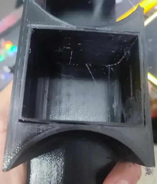

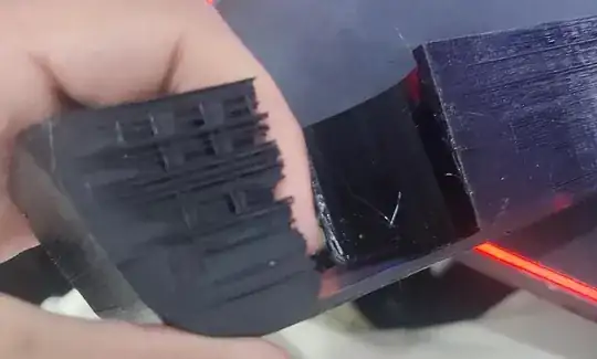

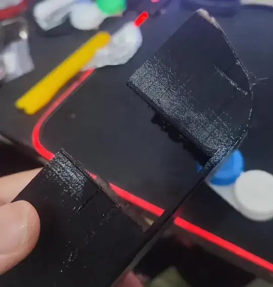

Using an Ender 5 Pro, printing at 0.28 mm lowest resolution.
As per that subs recommendation, I've tried the following with not a shred of difference:
  • Different speeds down to 40 mm
  • Temps from 230-250 °C
  • Fans from 0-50 %
  • Calibrated E step
  • Changed retract before outer wall to off
  • Outer wall flow 105 %
  • Main flow to 105 %
  • Top skin overlap to 50 %
  • Ironing on
  • Retrimmed Bowden tube
  • New nozzle
  • Cleaned out hot end
  • Relevelling
  • Also happened directly after dehydrating
Seems to be something completely transient to these settings as it happens in the same place every time regardless. Are these under-extrusion spots? Should the PETG have a bigger baby-stepped Z gap?
Also seems like the first layer and other layers print what should be a straight line into an angled line (see top delamination). Completely stumped.

Go a lot slower. 40 mm/s is near the max speed for PETG on a stock Creality bowden extruder at 0.2 mm layer height. You're aiming for nearly 50% more flow per unit distance, so you need to drop speed proportionally, down to about 25-30 mm/s.
If your problem is isolated to only certain spots, it's likely that those are the only spots where you actually achieve and maintain the requested flow versus slowing down and speeding up over and over. It's also possible that you have oozing during travel (especially travel inside the boundary of the part, if your slicer is doing that unretracted) or that the extruder is slipping during unretract, producing missing extrusions.
