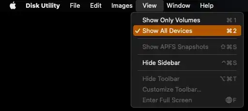

Disk Utility can be used to format the drive, but first, you'll need to change the view settings to enable the Scheme options when erasing the drive.
In Disk Utility, from the View menu, select Show All Devices:
Screenshot of Disk Utility's View menu with 'Show All Devices' selected

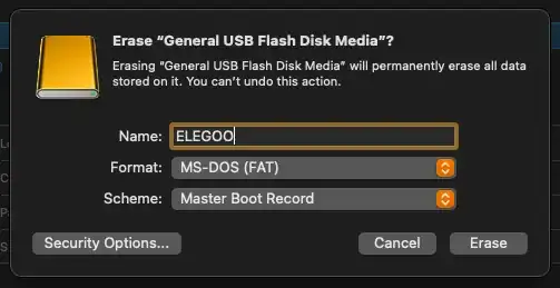

Finally, after using the Erase button in the top bar of the window, you'll now have the option to select the scheme:
Screenshot of the dialog box showing the erase options
Erase the drive using the MS-DOS (FAT) format and Master Boot Record scheme. The name of the drive likely doesn't matter. Using these settings, I was able to copy some files back to the newly-erased drive and the printer immediately found the files and was able to begin printing again.
