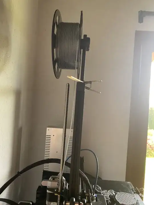

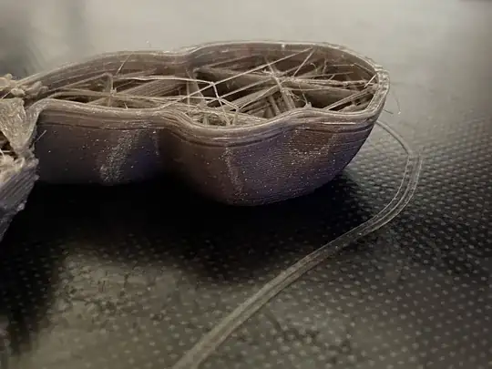

I have an Ender 3, I changed its extruder for one metallic one. In my last prints, I am getting issues at the same height. The extruder can't pull the filament in for that z position. I cleaned the Z axis, applied oil, and adjusted the eccentric nuts. I have minor improvements but still have many issues with my prints. I am thinking of changing to double z-axis, but I'd like to use my printer now.

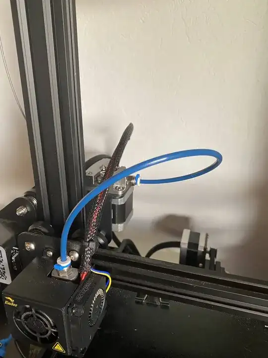

    Welcome to 3D Printing Stack! Can you post a photo of your filament path? This seems like you might have something jamming up your feed at a certain Z height. – Zeiss Ikon Sep 27 '22 at 16:03
  • Is it every print that fails at this Z height, or just *every attempt* of this particular print? Whatever it is, this is an extrusion issue, not a Z motion issue. The problem is not the rollers and will not be solved by dual Z. – R.. GitHub STOP HELPING ICE Sep 28 '22 at 01:10
  • @ZeissIkon I double-check the filament track. In theory I fixed it already. – dobleUber Sep 29 '22 at 03:19
  • @R..GitHubSTOPHELPINGICE every print in the last three weeks have the same issue. You are right. I am gonna post more pics soon. Thanks. – dobleUber Sep 29 '22 at 03:21
  • What do you mean by "In theory I fixed it already", if you fixed this please share through an answer. Both filament track and filament spool (winding) look too good to explain extra resistance caused by entanglement or kinks. – 0scar Sep 29 '22 at 17:49
  • The extruder couldn't pull the filament. I had to pull the filament by hand every few minutes. That part was fixed. But my printings have errors yet. Around the same Z heights. – dobleUber Sep 29 '22 at 22:00

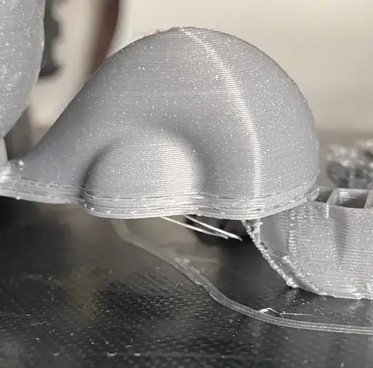

  • OK, based on the new pics you added this looks like a massive layer shift, vs what looked like an extrusion problem in the original post. So it may very well be something wrong in Z motion at that height, causing a nozzle collision and thereby layer shift. – R.. GitHub STOP HELPING ICE Oct 04 '22 at 05:12
