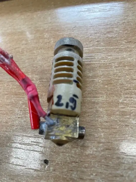

I have an HBot 3D 1.1 printer (it's a CoreXY style printer, newer versions are produced by ZMorph). I think that a filament guide tube inside the hotend got damaged, resulting in decreased diameter, which means I can't push the filament through it. It stops halfway through the heatsink (black marker in the attached photo).
I need some help, I'm not sure how to disassemble this type of hotend. With my Ender 3 which I have at home, I can just unscrew the nozzle since it's simply a hexagonal nut, but here it seems that the nozzle and heat block are one part and I don't think I can unscrew the heat block and the heatsink. I'm not sure what to do.
I'm sure the nozzle itself isn't clogged. I've done some cold-pulling on one end, inserted a thin wire from the other, and examined the insides with a flashlight.
Photo of the heat block and nozzle of the HBot 3D printer

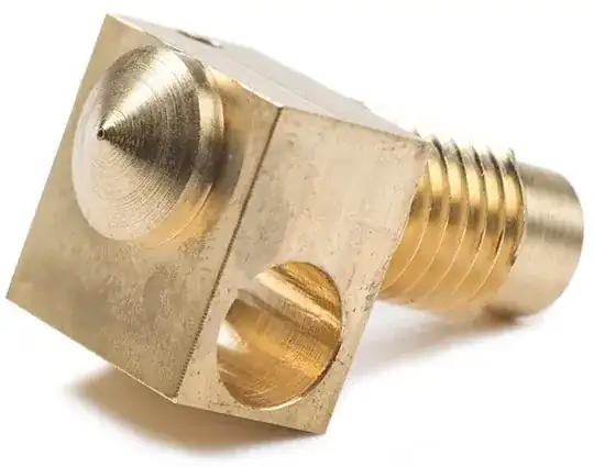

This is an old hotend type, it is called a J-Head (see e.g. the J-Head Nozzle Mk V, I'm unsure which exact version you have). The hotend is serviceable, you can buy separate "nozzles" (with integrated heater block) for it in some e-shops. You should be able to unscrew the "nozzle" from the PEEK nozzle holder. The milled flat surfaces indicate that you can use a 13 mm or 1/2" open-end wrench to disassemble the PEEK nozzle holder.
The "nozzle":
