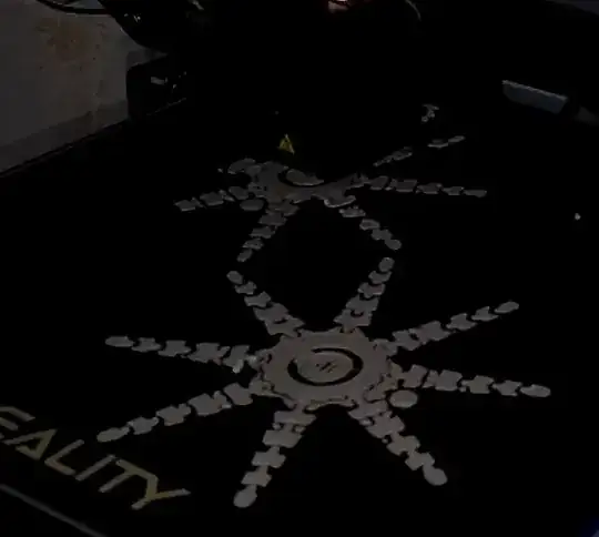

However, around the time these jumps were occurring, the plastic wouldn't adhere to the plate correctly. Some parts wouldn't stick:
Photo of the first few layers of a printed model with edges curling up
Compare the bottom (printed first) to the top (printed last). A lot of edges are popping up (although the bottom isn't perfect either).
