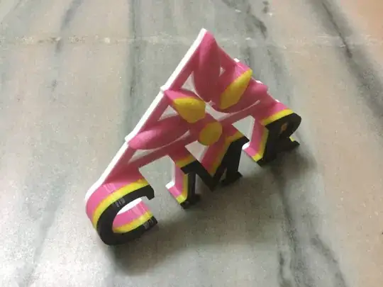

Design a product in such a way that it has different heights that can be seen in one plane.
By using direct drive extrusion we can easily change the material of different colours with out pausing the print to obtain colour print.
Example of multicoloured print
