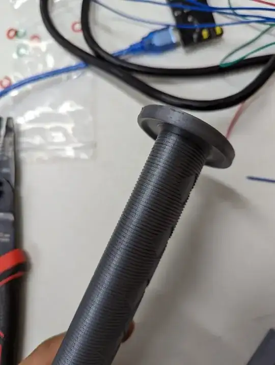

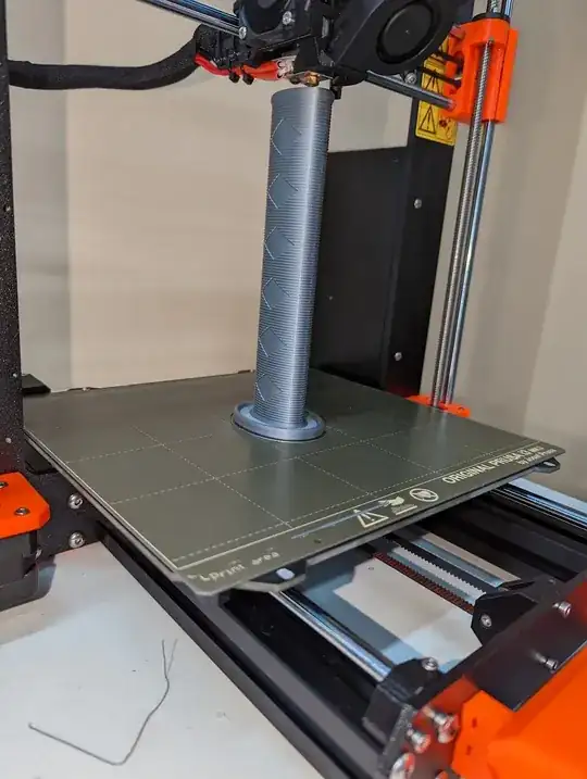

The print is a collapsible sword I'm using as a test. Everything seems fine on the outside, but inside it seems the segment parts of the sword inside the hilt are fusing together at the seam lines causing them to stick together.
Model: https://thangs.com/designer/3dprintingworld/3d-model/Collapsing%20Katana-22696
Finished Print (looks fine) enter image description here

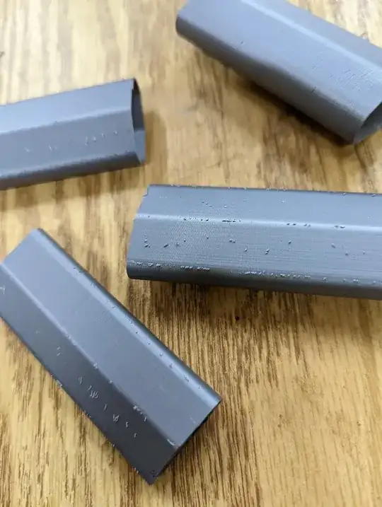

Concentric blade pieces (fuse marks that I sheared off and broke to get out) enter image description here
Seams on exterior of hilt look great enter image description here
Print settings/info
Printer: Prusa MK3S+
Slicer: PrusaSlicer 2.5.0a3
Settings preset: 0.15 mm QUALITY
Filament: Prusa PLA
Nozzle temp: 205 °C (default is 215 °C, but lower eases stringing and has never been a problem for many past prints)
Nozzle size: 0.4 mm
Full config: https://pastebin.com/ECa6KkYK

After some trial and error I found that the issue was stringing due to excess moisture in the filament from being stored outside of a sealed low-humidity container for long periods.
After placing it in a heated dehydrator for 2 days, my next print had low stringing and did not bond interlaced parts together significantly.
