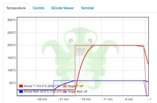

Here's an example of the hotend temp profile:
Screenshot of OctoPrint's temperature graph

    Could the temperature drop coincide with the model cooling fan coming on after the first layer? I'm wondering if you're running a 24V hotend on a 12V supply..? Or that the hotend heater has a problem. – BobT Mar 27 '22 at 15:52
  • looks like your code tells the printer to turn off - the light colored lines indicate that. OOOr, of course, layer end and airstream from the part cooling fan hitting the hotend. – Trish Mar 27 '22 at 18:02
